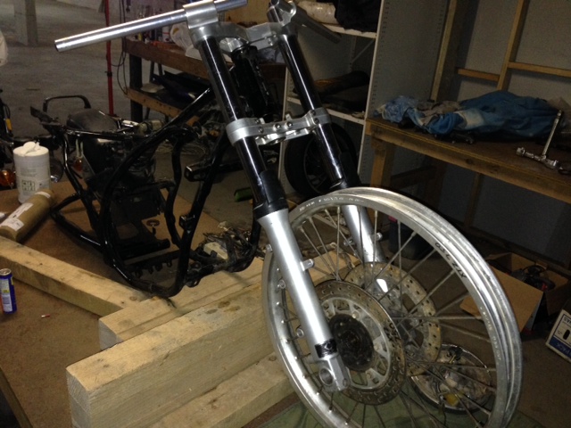

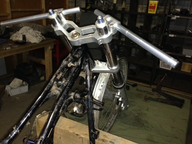

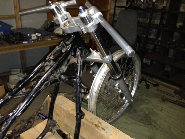

OK, so call me a little crazy, but I like doing things a bit differently and while i'm waiting for Pipes and Rad for the Hybrid thought I'd get around to cleaning up my Head Space which has had a few ideas bouncing around about what to do with the spare parts I still have left.
Ive had this Rizoma top triple from an FZ1 that i just couldn't bring myself to offload and a set of R6s RWU forks which were right diam but wrong triple. Anywhoo I went ahead and sourced the lower Fz1 triple and bingo, she fits and so do the R1 Blue Spots i've had sitting around, straight on the forks no adapter.
So I got an old RZ triple, got the center pressed out and the pressed back into the FZ1 lower, grabbed a new set of LC Taper bearings and Bingo, what you see is what you get
Now i''ve also been toying with the idea of Spoked Wheels, but this is causing more headaches than the $$$ in my pockets can handle.
Have been chatting with Jon W re this and he suggested later model Adventure Bikes might hold the key, but so far i'm coming up dry.
I picked up an XTZ750 Super Tenere front wheel and thought id landed on my feet, dual disc, can accept the speedo drive (small mod) but..... I can't fit the Blue Spots, Bugger..
So anyone got any ideas on what I could do.
Different calipers that might fit ???
Different Front Wheels ???
All crazy ideas considered..

You're right, bit of a brain dump.
Just thought id see if anyone had any experience with Spoked Wheels on more modern forks etc, as I have already done the RGV conversion on my Hybrid.
The 21 inch was mainly for the hub and twin discs but was thinking of re lacing to 17 rims.
The issue with Blue Spots is clearance on the spokes. Mags don't have this problem but the spokes angle out. It looks like most calipers for Spoked wheels are only 2 pot on the outside wheras the Blue Spots are 4 pot having a greater mass on the inside of the caliper which engages with the spokes.

Yeah spokes and calipers is always a worry. Do bear in mind though that:
1, the angle will change when you relace and you can space the disk and caliper over a bit as well with bracket/spacers
2, using larger 320mm disks will move the calipers out more towards the rim as well.
....but... well, yes space will always be tight for calipers with opposing pistons.

GMU they don't really matter all that much. Most of those things can be fixed easily with spacers, or adapter plates, bearings etc.
The hard part with using the spokes with modern forks is getting the newer 4 pot calipers to clear the spokes, not whether you can get the hubs, discs etc to fit.
I really wanted to know if anyone had any knowledge / experience of making a spoked wheel work in a modern front end and if so what has worked for them?
I have tried a few options now and the xtz hub is pretty good, it will certainly work in the front end, with spacers the discs lines up well and I can source bearings that work with the R6 axle.
The Blue Spot calipers bolt straight on (83mm), and I think if I changed to oversized 320mm rotors (which are direct bolt hole match to KTM / WR) I might bring the calipers far enough out to just clear the spokes. If not I might have to include a small adapter plate for the calipers to swing em out a bit more.
Some others have skimmed / ground down the back of the calipers to make the fit and others have fitted Low Profile Brembos.
Its very popular to use XS650 hubs (as a good friend pointed out to me and / or Aircooled Hubs which i may yet do as I have an XS650 hub coming but not sure yet.
If I could I would use an RD400C hub for the rear (if you can find one) but I have also investigated both Triumph and Ducati rears but I do still like the drum brake / cush drive of RD so will play further with that later.
I really don't want to modify the swinger. Already done that before and have a few spare swingers etc, but as i really want to keep the period look it will have to be the original / slightly mod original although until I get the front sorted i wont bother with the rear incase i have to go back to mags or original wheels.
