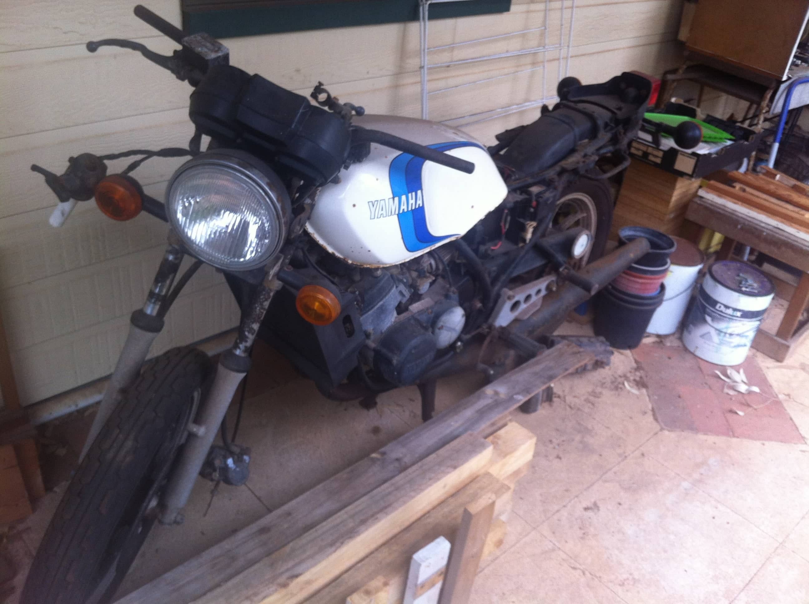

Re: RD350LC resurrection
got it on there
- got it
- (240.88 KiB) Downloaded 13 times
those forks are beyond redemption. - new fork legs for you me boy .Mullna wrote:got it on there
Actually it looks like it has been exposed to the weather for a considerable time. I would expect a complete pull down and rebuild - new tyres, brake rebuild, engine pulled down, bearings gaskets etc etc - say $1000-2000 - depending on the originality and appearance you want - 6-12 months of work and part/info searching. Both time and cost will depend on the determination, time and $$$$$'s you have or are willing to throw at the bike.
