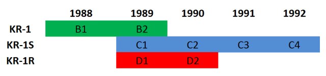

anyone know how to identify a kr1 to a kr1s please
JKAKRMC1-LA001xxx
cheers

KR1 has ridges on the frame rails and the KR1S has a smooth frame rail. The S has five spoke wheels and the KR1 has three spoke wheels the S has a rear shock with a remote reservoir the KR1 does not.

thanks for that mate
i found this so i can assume its a kr1s
it seems the the uk and other countries use a different vin to oz not to sure why though

An S has KR-1S on the tank as well :D
