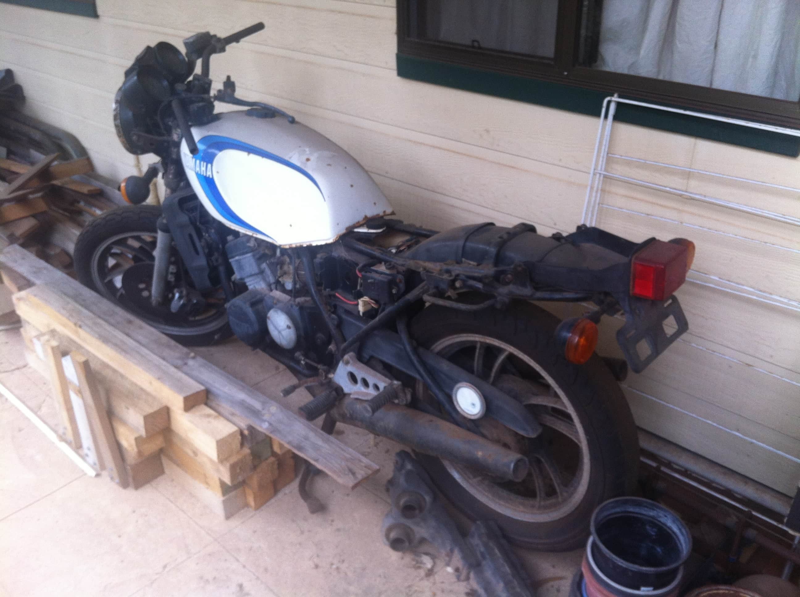

I have some photos on my phone but it says they're too big ill try on the PC when I get home.
She's by no means in great nick. But I can see the potential

got it on there
got it
(240.88 KiB) Downloaded 13 times

Re: RD350LC resurrection
Mullna wrote:got it on there
those forks are beyond redemption. 8O - new fork legs for you me boy :wink: .
Actually it looks like it has been exposed to the weather for a considerable time. I would expect a complete pull down and rebuild - new tyres, brake rebuild, engine pulled down, bearings gaskets etc etc - say $1000-2000 - depending on the originality and appearance you want - 6-12 months of work and part/info searching. Both time and cost will depend on the determination, time and $$$$$'s you have or are willing to throw at the bike.
