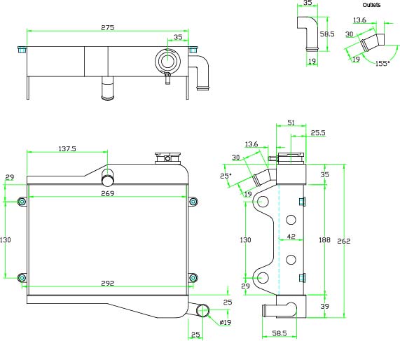

OK, well heres my first attemp at doing a drawing for the RD.
This is what the RDLC comes out like, sorry for the poor quality, but its a start.
let me know how you want to adjust it and measurements etc, and ill try and make changes unless anyone else has a CAD program or something and want to have a crack.
If this is OK Ill do the current RZ rad so you can compare and then make our own version ?

Anyway, love the diagram Pete, very cool. will have a gander at my figures and get smads to measure up his rad for me as he has about 1,5l of coolant in it.

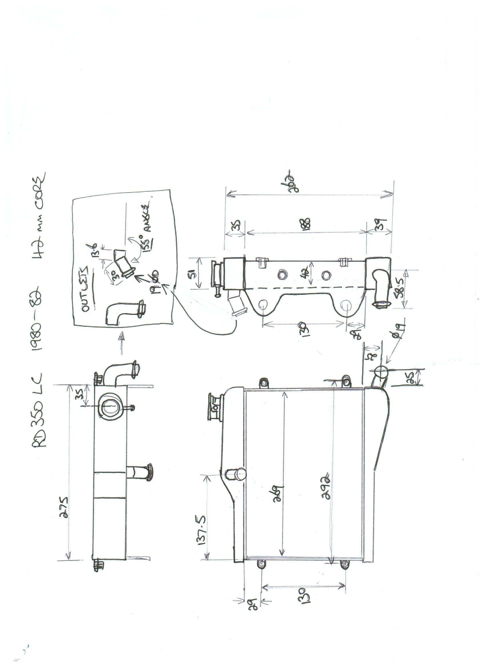

Try these Chinese don't like 'mud maps'
http://www.support.scan2cad.com/tuition-videos/
http://www.img2cad.com/
If not email it to me and I'll run it through my convertor

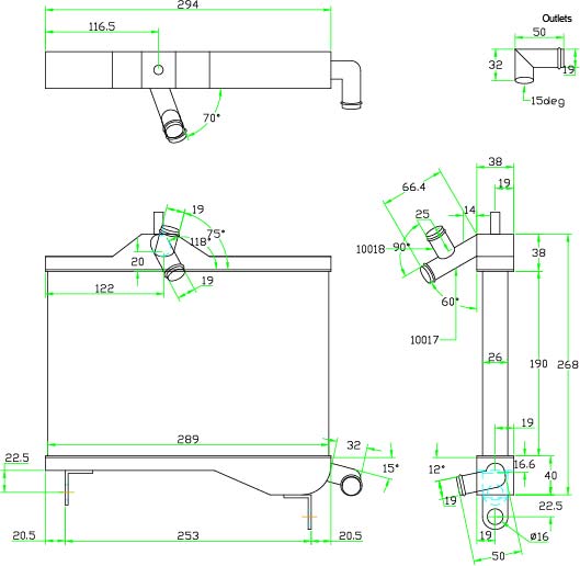

OK, so here is the RZ version, done in Illustrator and I have output file into CAD and AI files for checking and they work.
Next Ill re-do the RD.

And heres an updated RD version

OK, so now all I need is input in regard to changes to make / measurements etc, and ill try and draw up our "OWN" version.
One thought is that perhaps we could make a base plate / bracket with multiple mounting points so thereby providing a universal style fitment for either type of frame eg RZ / RD.
Perhaps this could also incorparate an area for fitting a fan / fans aka the R6 set up on some others hybrids etc.
This way perhaps you could get one style of Rad made that covers all the bases for connections etc, but allows fitting to diff style frames ?
Anyway, let me know what you think and ill see if we can draw it up.
