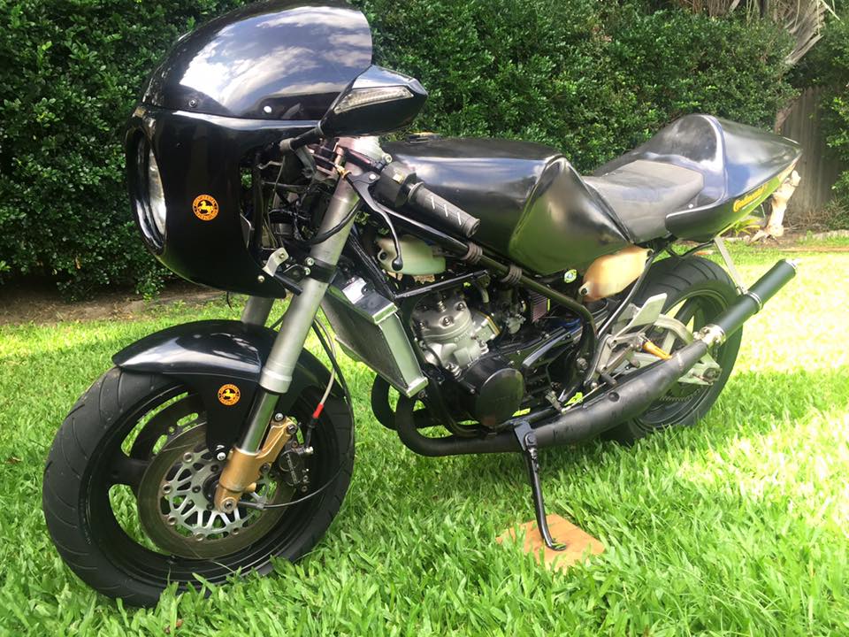

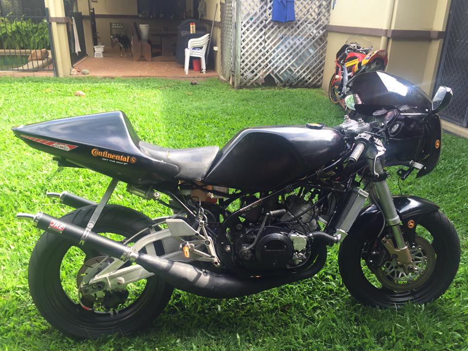

Well i have been gone a while not sure if many people remember my little one but she is now mostly complete thanx to a couple friends and a lot of patience!
Here are a couple pics. download/file.php?mode=view&id=496
Just getting the seat covered to get road worthy.
Not complete yet. Need to get a proper fairing kit. Will be a bikini type and a few minor things!
Hopefully brings a smile to some faces.

glad to hear youre almost done, she looks like a beast!
Whats the bike in the background? CBR6?
