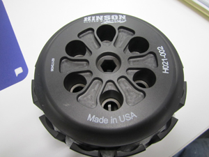

Hinson Billet Clutch is finally arrived.....
- Clutch is finally here !!!
- a hinson.jpg (67.3 KiB) Viewed 4916 times

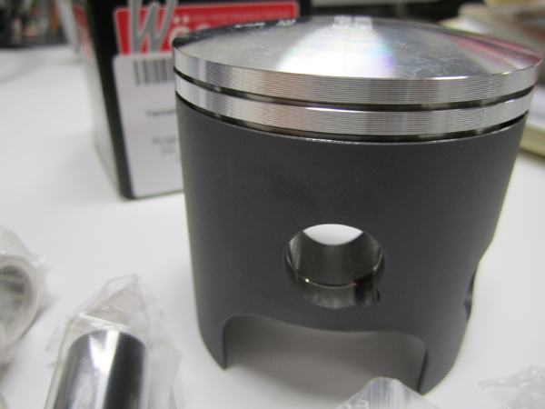

Pistons have arrived also, now we're getting somewhere - at last !
- Nice.... Wossner look OK
- a wossner.jpg (166.74 KiB) Viewed 4913 times

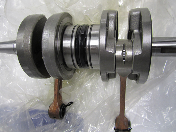

Yes, just unpacked the crank too !
- TSS Crank
- a crank.jpg (219.16 KiB) Viewed 4911 times

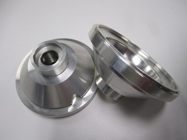

TSS Head Inserts for the Athena kit...no stepped edges here now.
- TSS Head Inserts
- a inserts.jpg (175.33 KiB) Viewed 4910 times
Ohhhh Nice! more Sexy stuff! nice work m8! I got my Athena kit the other week, domes are done, fitting Wiseco offset pistons and also a TSS crank like yours. Our engines will be quite similar i reckon. Ive grabbed some Vforce3's and a Wicked Motorsport hidden crossover manifold as well as a set of fat belly pipes... busy busy!

Wicked also did the domes for me on his lathe when i was there as I am fitting Wiseco 573's and dont want to run a spacer plate, much the same as your spec etc.
