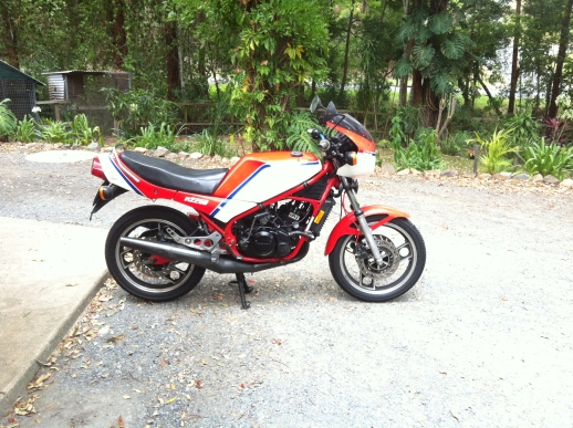

Finally got Myself an RZ250R

Firstly thanks everyone for your tips and wisdom. I had a frustrating day with the RZ yesterday. Took it for another run out the Old Rd in the afternoon to get a feel for the progressive springs in the front. The forks have stiffened up and the dampening is harder, probably because I used 20W fork oil. This has changed the geometry of the bike and made me more aware of the rear suspension. When I was riding through the tight corners with the power on I was aware of the rear wheel tending to skip occasionally. This could be the old tyres, rear pre load or rider. The bike drops into corners quicker but I'm thinking about changing the fork oil back to 10W. When I got home I played around with the pre load on the rear. It was on 3 but the shock seemed old and the sag didn't seem to change much from 1 to 5.
The other problem I encountered was the engine. Two days ago I had a nice smooth power band nearly all the way through the revs. Out on the road yesterday it was getting hot, the engine was four stroking between 5000-6000 and by the time Id got home was running rough and rattly below 4000 too. I got off hot and frustrated. Bloody 2 strokes! I checked the plugs and they seemed ok, a bit sooty but not fouled. I'm not experienced in tuning twin carbies, don't even know how to find the needles and so Ive got to get some education about jetting from somewhere. Found a good thread on the UK site called Spankys Jetting Guide but it just felt a bit overwhelming last night. Need to break it down into bite sized bits, but that was one of my reasons for going down the 2 stroke path.
My original idea for this bike was to have a crack at building a 2 stroke cafe racer, but because it is so original my plans have changed. I do like the idea of having good brakes, tyres and suspension but not to the extent of changing forks, wheels and swing arms but I'm certainly not adverse to braided lines, better calipers, sports tyres, suspension etc. I'm also finding it interesting in learning the art of riding a bike from another era. When this RZ is running well its a beautiful exciting machine, but when its bad its horrid! So the saga continues.
PS: Just took the RZ for a quick spin and its all fun again. Maybe it was a bad rider day yesterday.
