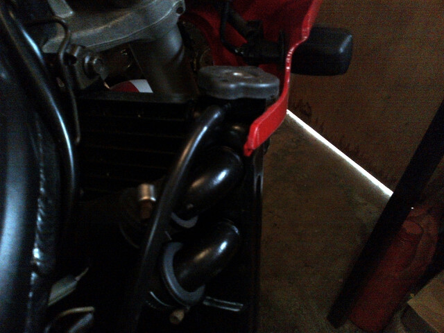

I wouldn't worry about that my 3XV SP has the same and they are right on top of each other.

What sort of pipes are they? Not sure about the blue engine casings
Re: New toy (TZR421) is on its way!!!
EPApolice wrote:I wouldn't worry about that my 3XV SP has the same and they are right on top of each other.
and no divider plate inside it?
No I can put in finger straight into the outlet. There are two outlets at the top under the cap, the lower one is capped off and there is one at the bottom on the other side
oh, so from what I understand, your radiator is different.
you have two outlets on the right and 1 inlet on the left?
so all flows have to pass through the radiator core?
I've found what I think MIGHT be a deformation where a divider could be. but Ill check for sure in the next week or two.
Yea disregard what I was saying I was having a blond moment.
It's a dual pass radiator, the rad is effectively divided in half acroos to the left on top and back to the right on the bottom.

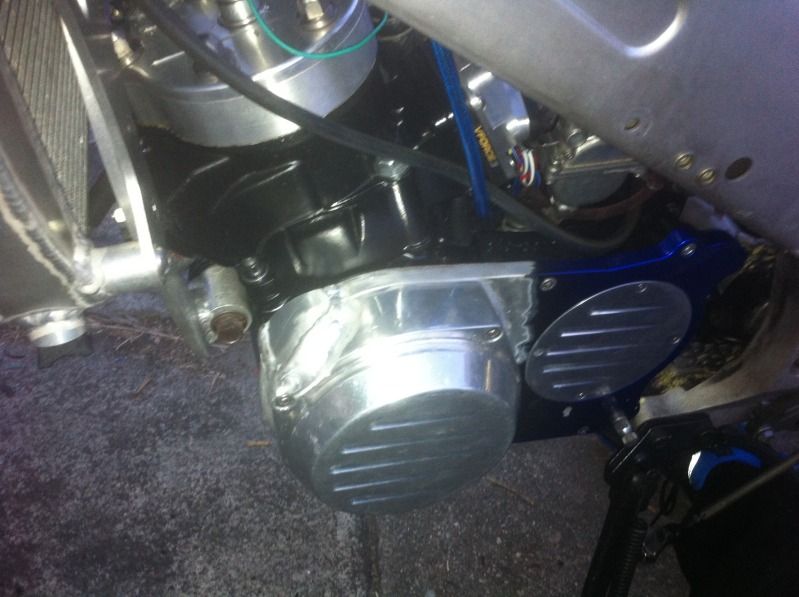

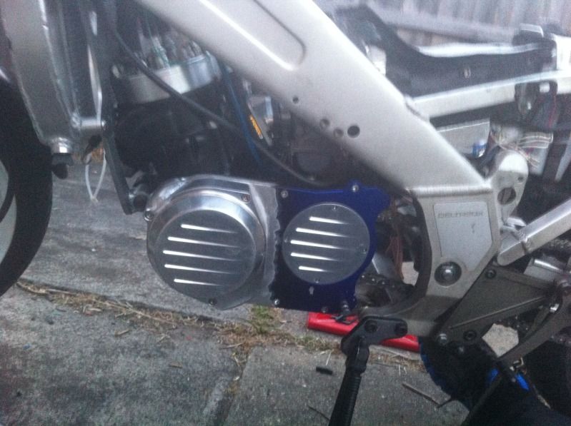

Got my box of goodies from the seller this week!
First off, I fitted the Two Stroke Shop dual pickup stator and flywheel
Only things left to do is waiting for some short counter sunk screws to turn up in the post to neatly (neater) mount it to the cases
Then ill need to get the side cover welded to the side plate (blue section) with a shaped piece of ally welded over the hole as I had to cut through both of them to fit this set up.
It was a bit of a butcher job, but once a patch is welded over the top to make it water tight it should look pretty good.
Ill probably consider getting both side covers repainted black to make it more of a 'sleeper'

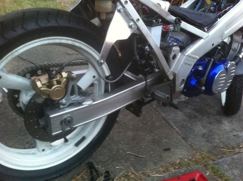

did a bit of spring cleaning this week on the bike. pulled the swingarm and shock out of the bike so I could thoroughly clean them up
I also got the modified side cover back today which is great considering it didn't cost me a cent.
Should look great with a coat of satin black paint
THe pipes are also off the bike as I want to clean them up a little and also trial fit Fred99999's Wicked racing RZ pipes to see if they'll fit
