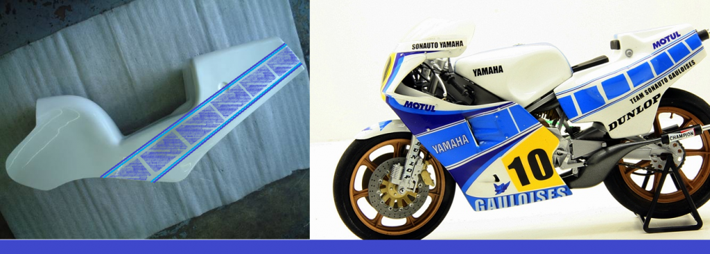

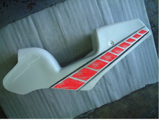

Need some opinions for paintwork
Ive been busy in MS paint trying to work out what the best paintjob will be and its mostly been playing with the yamaha speed block design.
what are your thoughts?
RZV500 insprired

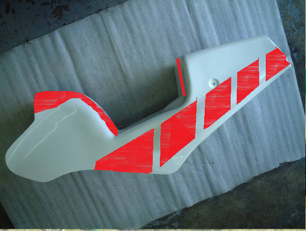

TZR3ma/TZ250 inspired

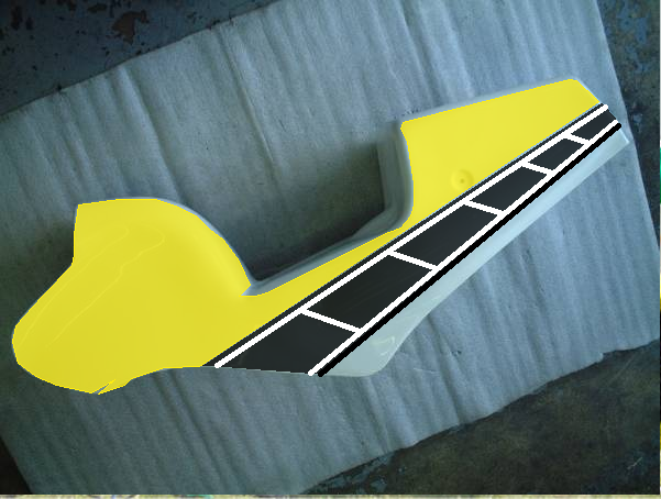

Kenny insprired (but I think yellow/black is now an overdone color scheme)

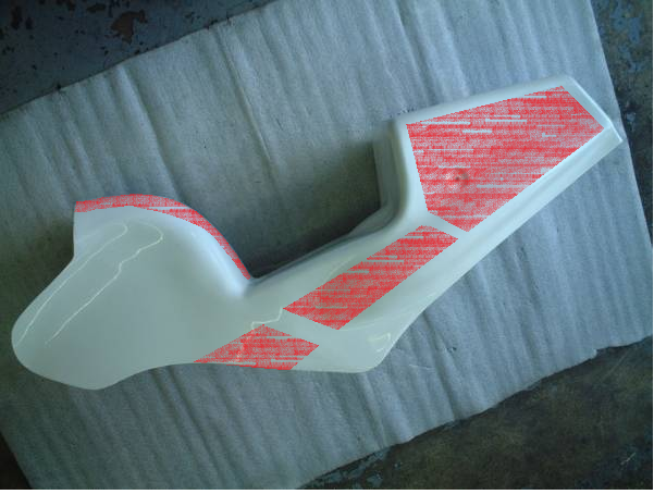

yamaha M1 red/white/black inspired
british 250GP championship bike (blue)

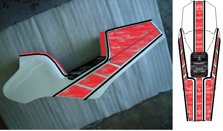

my own take on the speed block design that blends the side panel speed blocks with pin striping on the top of the tank and tail.
