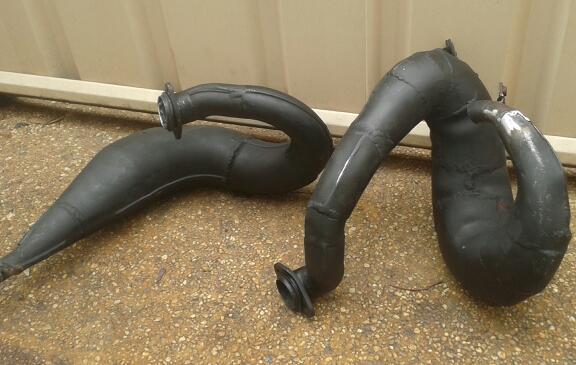

The KR runs a 137.5 main jet but I would suggest your pipe is going to be a major problem. Just because it fits in the space on the bike doesn't mean its going to work right. I see a huge meltdown coming up.
Re: Crafting a kr250a1 motor into a dirtbike frame ???
Wasn't that they way to define the perfect 2 stroke pipe? Once it is the right dimensions and size it cannot possibly fit the chassis or if it does, the bike wont move or lean?
its a bit hard to see in the video, but it seems that you've moved the stinger offtake from the end of the pipe, to the belly section.
This should work fine, but one thing you will need to do as a minimum is you will need to cut the end off the pipe where it has the blunt end, fabricate a cone section of the correct dimensions and weld it on
I couldn't work out how the pipe was done.. my head was about to explode, so I gave up.
As you say Jeram - stinger out the belly is fine, but the end cone is still required.. otherwise you might as well have a straight through pipe really. I guess the belly and stinger will provide some back pressure, but no real return wave without the end cone.

fred99999au wrote:Wasn't that they way to define the perfect 2 stroke pipe? Once it is the right dimensions and size it cannot possibly fit the chassis or if it does, the bike wont move or lean?
Here they are
Here they are

The stingers were added later they were 24mm id and about 500mm each to the muffler whitch is a single unit with twinn pipes all the way threw. I dont think the shape is that bad realy ossa makes a 300cc enduro with the pipe the same way thats where i got the idear

I undersatnd how a pipe works and i know that you cant just guess what size to make thats why i used a pipe calculator and studyd what sort of pipes worked on the kr,s but i still know that there is a lot of complex math behind a good pipe and dont say i am a exbert at this at all
That sharp bend straight out of the exhaust port is not going to be great.
I think I remember lozza mentioning that a nice straight section out of the exhaust port is ideal. I applaud you for having a go though.. I'm all about it.

hybrid wrote:That sharp bend straight out of the exhaust port is not going to be great.
i see what your saying with the straight section working best.but sometimes we need to compromise between funtion and form thanks for helping keep me motorvated with the project and advice :lol:
