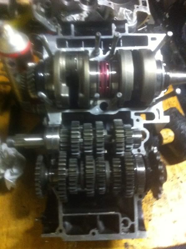

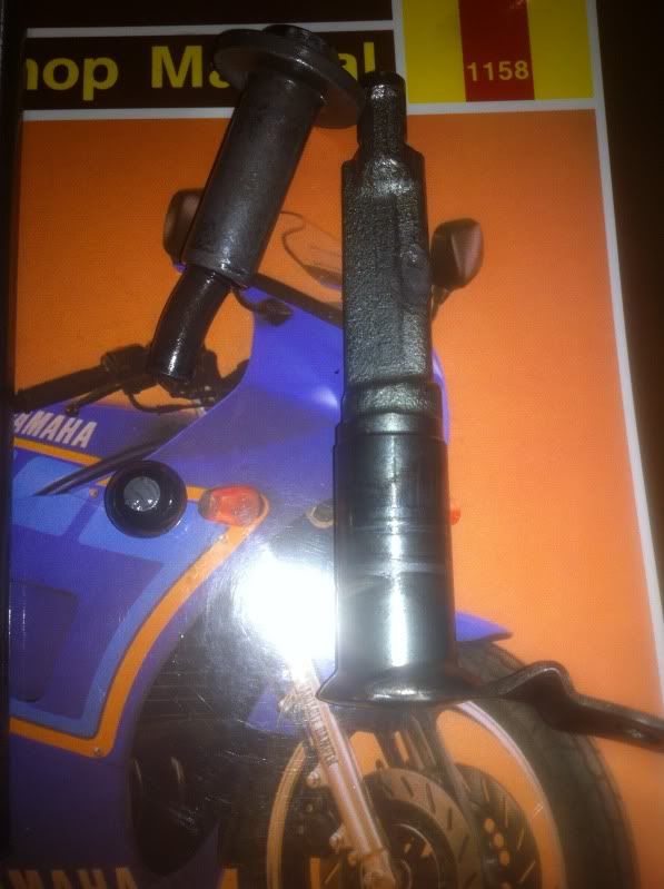

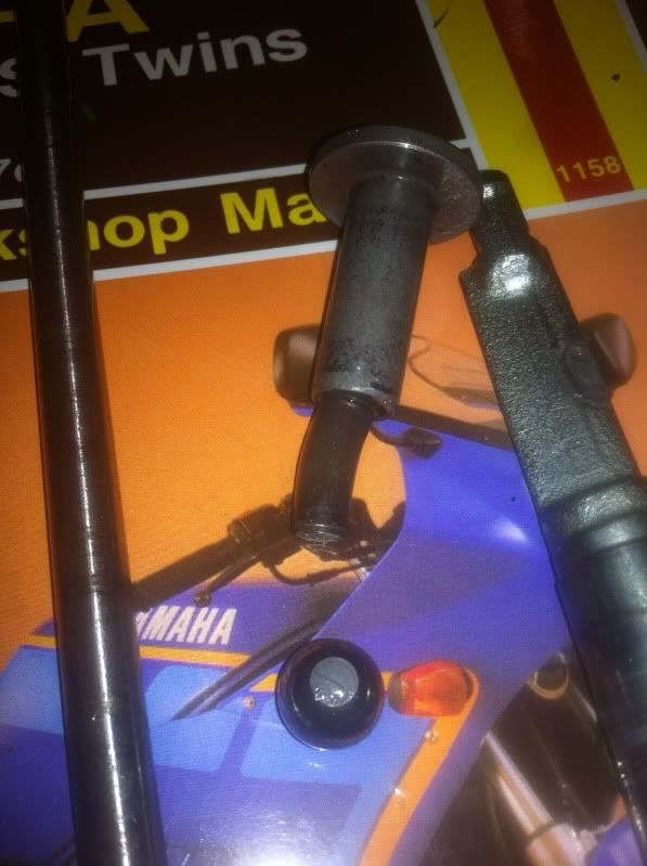

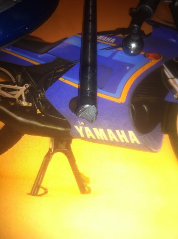

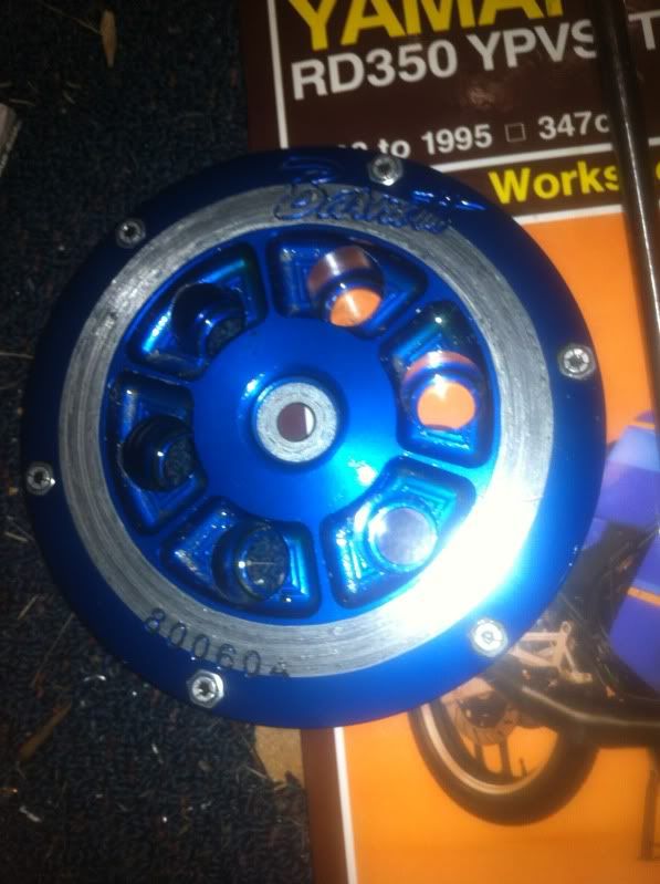

I ended up dropping the motor out of the frame and splitting the cases today as the clutch rod was mushroomed at one end and had the bearing welded to it at the other so there was no way known it was coming out.
engine looks perfect on the inside
damaged clutch rod
scratched clutch pressure plate

welded/damaged actuator arm
bent clutch adjuster which fully wound out of adjustment when the lock nut came loose, causing the carnage.
And the cracked clutch cover which I couldnt get a decent picture of.

Never seen the cases split that way before,dropping the whole shebang into the top case,would be easier.
Re: New toy (TZR421) is on its way!!!
Yeah it's very very easy :) I'm liking these vertical split cases a lot!
