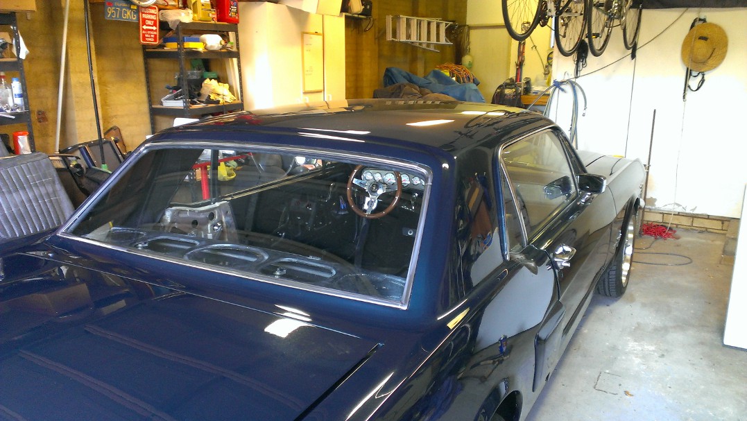

Nice Mustang, BTW.
Don't let the Missus convince you to sell it ;-)
Re: KTMito 380
The Mrs loves Mustangs - it should be staying.
