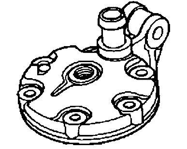

CR250 2007 stock OEM head (the Phathead racing head isnt going to work on my bike)
