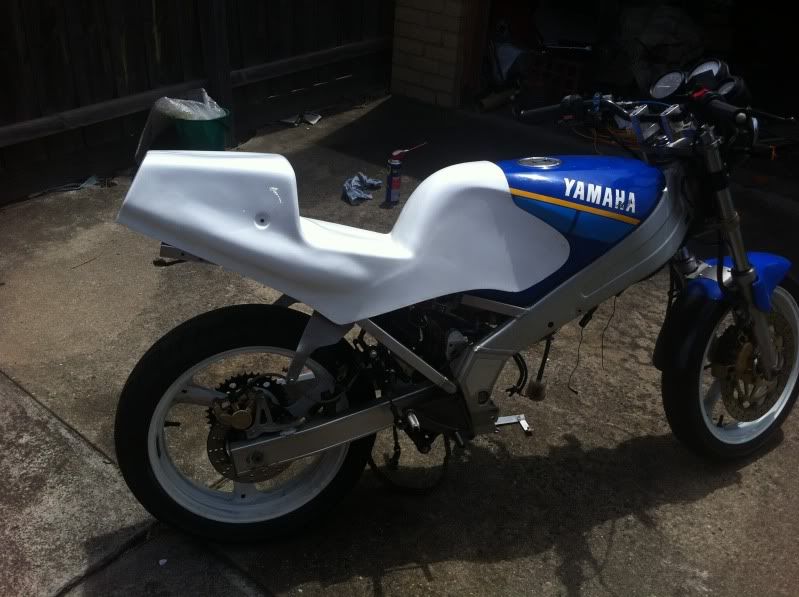

Here we go, I've got all the bits I need to rebuild the engine now and also look what else showed up in the post today.
Ill be properly fitting this and painting it in the new year.

Now I've moved onto modifying the sub-frame for the new tail section as its not a perfect fit as I thought.
So I'll be chopping the rear portion of the subframe with a plasma cutter sometime this fortnight to make it all fit nicely.

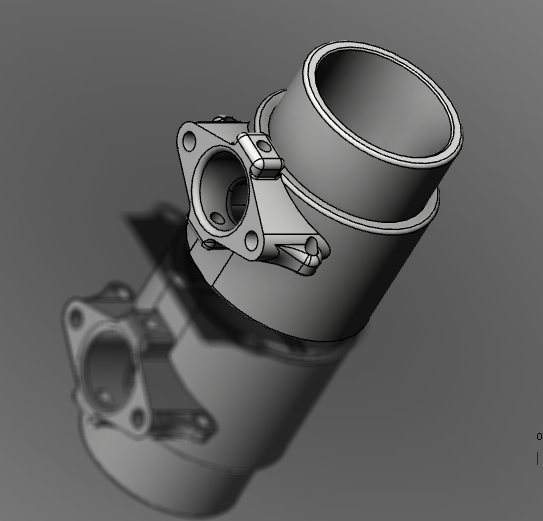

I've also been working keenly on building a powervalve for these non-PV cylinders.
Its a component designed for both Cub and Athena style cylinders to boost bottom end and midrange by a considerable amount.
I sent off the CNC files to an engineering shop this week and hope to have the first prototype ready for a trial fitmet in the next month.
I have high hopes for this tried and tested idea (expired Honda patent) as it will allow the cubs to have the mid range of the cheetah motor while still retaining the blistering top end of the cubs.
I hope to have these on the bike for testing by early autumn. perhaps in the future I will be able to offer these for sale
Should have her up and running, tested, dyno'd with the 'powervalves' in time for the Easter Bike Bonanza at Broadford raceway. If that's the case Ill slap on some 125GP slicks and see what she can do around the track!

Fantastic Jeram! If you can get the PVs working then please put me down for a set. Im also happy to help with testing and productising if you need it.

Well you want to do some testing for me ill put you down for a discounted set as each cylinder (cub, Athena banshe or lc) will require a slightly different resonating chamber volume to move the benefits of the valve to the desired rpm. I can estimate it but it needs confirming.
So I'd just make a full volume one and then you stuff the canister until it works when you want it to.
Anyhow, first things first I have to get mine finished.
All I can say is that is the banshee guys spend a couple hundred on boost bottles that don't do anything I can't imaging how much they would pay for something that actually works! Haha

No worries Jeram, see how you go with the design and when youre ready drop me a PM. I have an Athena btw.
