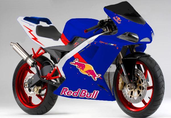

I have a colour scheme suggestion
(44.03 KiB) Downloaded 20 times
