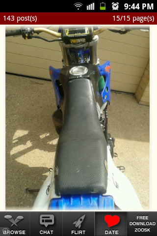

S pic

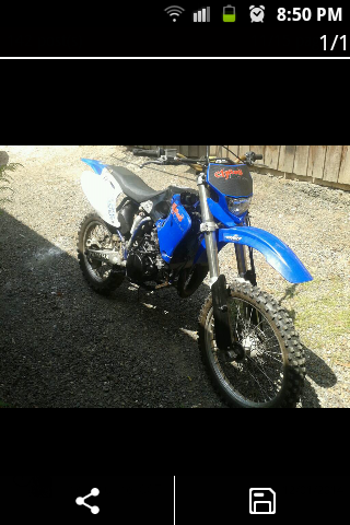

Post by azwood80 »
Here is a early one

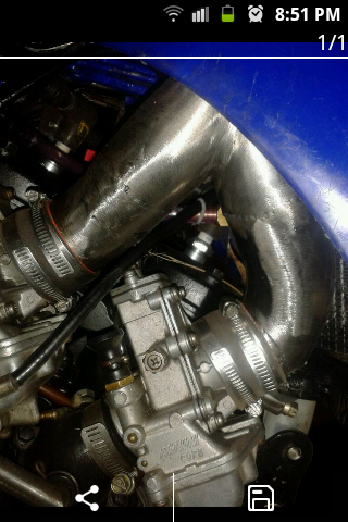

Post by azwood80 »
Air filter and intake system
