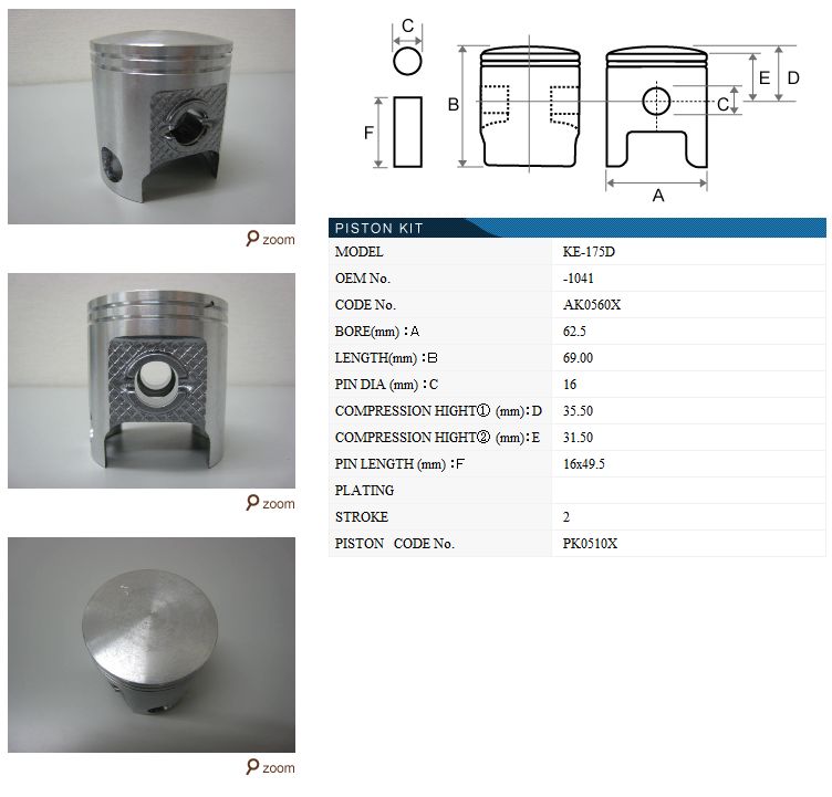

I discovered that Beet used to make a 310cc kit for the KR250. They used a KE175D piston. All piston measurements are exactly the same except for the diameter and probably weight. The windows and ring pins are also in the correct place. You must use thrust washers on either side of the small end though. KE175D pistons can be purchased from Bikes & Bits Importers in WA. You would need to bore the cylinders out to 62.5mm and have head gaskets made or the heads o-ringed.
This may not be the perfect solution, but may resurrect a whole bunch of dead KR's out there.
- (63.73 KiB) Downloaded 81 times
Two-smokin' barrels.

whats going on with those pistons around the gudgeon holes?
looks like they forged it with a waffle iron haha
Re: 1984 KR250 A1 - Pistons
That makes it easy to find where it orginaly cracked before it shattered into a million pieces.
