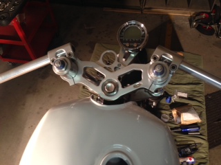

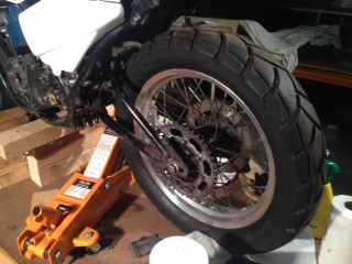

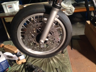

Quick update to where this is sitting. Parts are only sitting in place but you get the idea.
Rear Wheel - Kwaka KLR650 with Disc and Calipers, swingarm filed out 2mm to accept Axle.
Front Wheel - Yam XTZ750 Hub, re-laced to new 17 Rim and new bearings to accept R6 Axle.
Front Discs - New Oversize 320mm from Germany for XTZ hubs, will fit nicely but have to look at adapter plates for Blue Spot Calipers to swing them for a bit better clearance from the spokes and new axle spacers to center the hub.
Ive made up a bracket for a digital speedo to sit offset allowing the ignition to still function, and while its rough I kinda like it on these triples over the standard clocks so far.

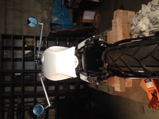

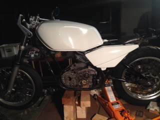

Seat has been chopped down and i'm currently playing around with the style, yet tobe decided, but it'll be a bit shortened over the standard.
Tank and Panels painted standard white and ready to fit, have spare decals sitting around but not sure if I should use them on this yet...have got a friend who is an awesome airbrush artist, does the really high end show cars so could get a wicked design but plain is good for now.

More shots

Anyway gist was that im liking it when I thought i wouldnt, but i like how the builder works so know it will be right etc.
I dont like the large LC tank with skinny seats and think you need a diff tank... and yes it should be custom graphics!
