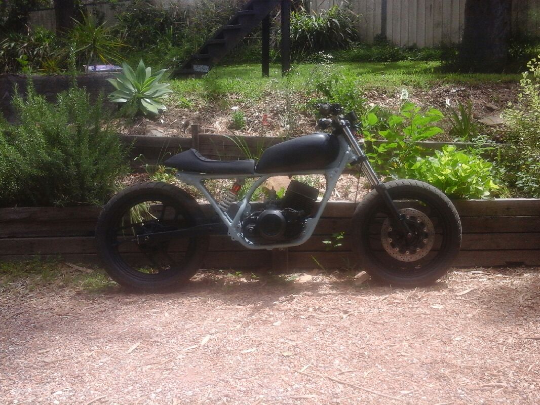

Well i have been collecting and trading parts slowly to get a bike together.. i wanted a simple aircooled with benifits of the later modle rd rz this week i got around to preping and painting and assemble.. this was all build from individual parts collected..there was never anytbing close to a complete bike to start with..break down is
Aircooled rd250/350 frame
Rz f2 rear end with fastace suspension
Front is nsr150 forks rz triple clamps rzf2 front wheel r6 disc nsr150 front brakes all lines up beautifully
Yamaha ag175 fuel tank
Engine is rd350lc bottom with rz crank and electrics top end aircooled 350
Rear sets will be from cbr150 already fitted but not off the bike,
Exhausts will be rdlc to be fitted..
rd air cooled

Mighty impressive given what you had. [emoji1417]
