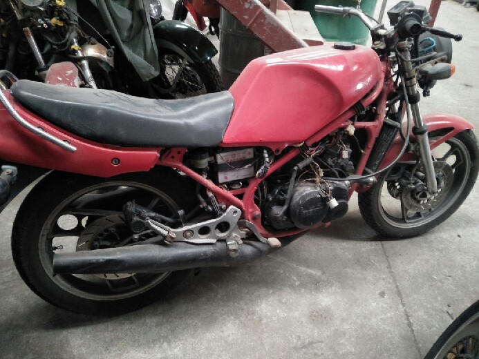

Well I felt I had been forced to buy an rz now before they become priced out of what I'm prepared to pay.. I looked for a while then eventually went down to old gold and bought a pretty rough 1983 250 with a 350 top end.. Not running.. Although it was showing its age.. The tight bushes perfect forks low wear on the discs and tight levers told me it was worth the risk of $2000
Here is a pic of it when I got it last week

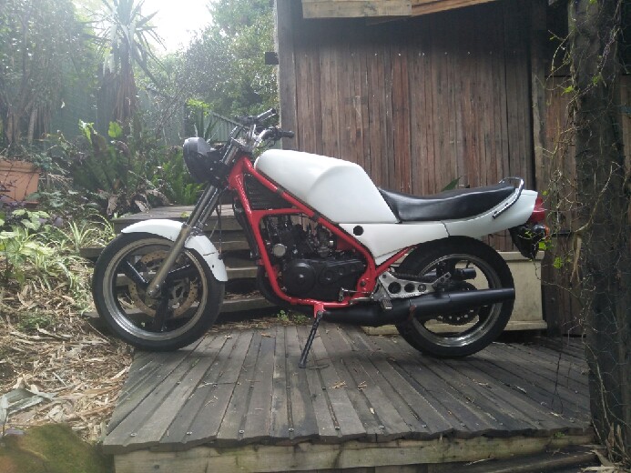

Now it's been a week since I got the bike and a lot has been done firstly was to get the bike running.. It started but only just.. Sitting for along time had the carbs in bad condition.. It coughed and misfired but It was enough to tell the motor was OK..
Then I totally stripped the bike and set about refurbishing everything. frame down to metal painted as with every thing else..
I also has a set of wheels from a Yamaha zeal and front forks.. I did a stem swap and used a rg250 front guard. it's a good set up and was pretty straightforward. New master cylinder and braided lines. Carbs were replaced with rg250 flat slides which fired up second kick and the bike idles lovely motor sounds great.
This is it after just a week all I have to do now is sort a speedo indicators and some other bits of wiring..
