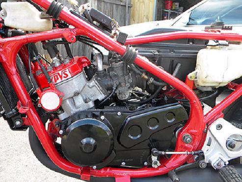

thanks to justin for info. does anyone know which model fzr250 brakes bolt striaght up to the rz. has anyone used tarozzi low race bars on rz?
the old girl. still need brakes and bars
489 smaller.jpg (64.35 KiB) Viewed 1187 times

hey mate fzr2503ln tzr250 3ma and tzr3xv will fit on .i think fzr400 too antman has tarrozi on his lc

just got a set of fzr 250 brakes and they bolted straight on . the pads are bigger and the four pistons look better than the origional setup. just waiting for handlebars too turn up to see what needs to be done with brake lines and mounting fzr mastercyl and remote resivoir!
