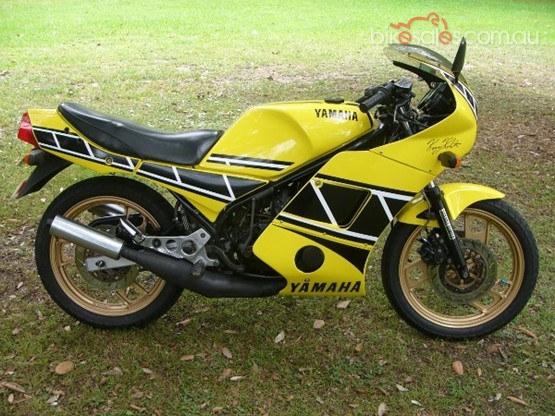

Just got my first two-stroke. An '85 RZ250 (supposedly with 350 top end). Nice complete bike. Had a good ride already but I have a few engine issues that will need sorting. As I'm new to these smokers I will need some help to get going in the right direction.
Does anybody know of a mob that is into these kind of bikes in the Shire or at least in Sydney that can help me get this motor sorted?

I'm sure it probably has been crashed, given it's age! I guess that's where the non-original (for Oz according to my limited research?) paint job comes from. One day, when I crash it, I will probably go with a naked style with more upright bars. Probably no need to be all precious about keeping this one stock as it's not a genuine 350.
When I was looking at this one, I almost didn't go for it as I could hear something wasn't right. So, instead I lowballed an offer and paid much less than the ask as I knew I would have to spend a bit to get it running right.
I got Al Mitchell from Kirrawee to overhaul the top end for me. Rebore, Pro-X pistons, 350 carbs, 350 oil pump and billet powervalves from Steve at the TSS, etc. I'm running it in now and it sounds good to my untrained ear - this being my first smoker. The rattle that was in the motor is now gone and it seems to pull pretty good once I have 3000 on the clock. I've only taken it to 7 or 8 so far, but I can feel it start to rip. Hard to override my 4stroke instincts when riding but I will learn! My other bike is a CB1300S and you can ride it quickly ahead of the traffic all day without cracking 3000!
