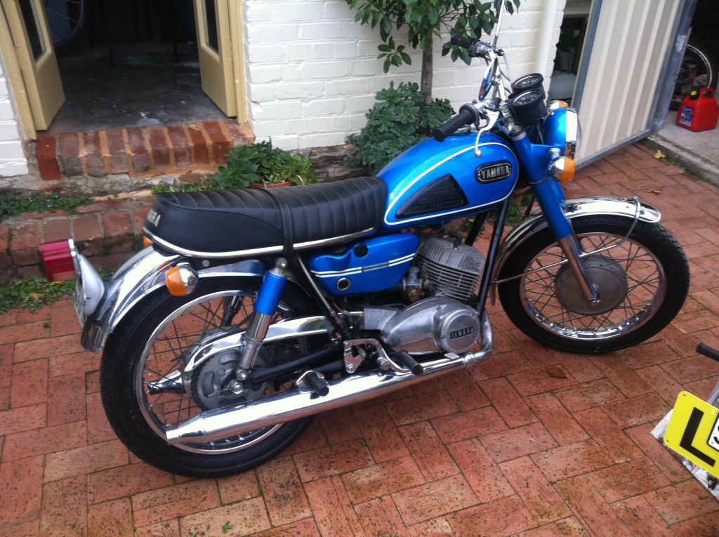

ive got a mint condition 1969 yamaha ds6 with 13,000miles. it runs like a dream around the street and hills. but i have one problem. at top revs it cant deliver the power.
going up the freeway in south australia it will only sit on 40 maybe 45mph. if its flat i can sit on 60mph but theres no more power to give. ive changed the sparkies, cleaned the air filters and baffles and the carbies. all i can think of is that ive broken a ring or something to do with the piston. i have taken the heads off and the piston looks alright, but im not to eager to take the whole pistons out and strip the motor cause i dnt wanna mess up the gaskets.
has anyone had this problem or does anyone know what the cure is.
- ive recently put some drag bars on it
- (172.73 KiB) Downloaded 71 times

compression/leak down test.
Nice original bike
