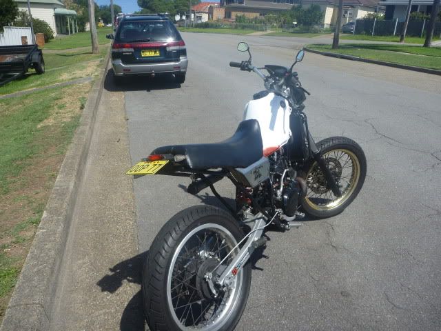

well i got tired of waiting for my "free" wheels so i bought a front tdr250 wheel from mark boddy..(thanks mark) and fitted it to my dt200l.
the got some road wheels to suit..this means it now runs 18" front and rear as opposed to traditional 17" on motards
i didnt have a suitable yamaha  disk so u used a late honda disk i modified to fit .
i also fitted a brembo twin pot non opposing caliper the kind ya find on a modern ktm etc
also a trail tech speedo
it all came out very well such a fun bike ...if a lil  scrappy lol
here is a pic
http://i36.photobucket.com/albums/e47/t ... 020362.jpg
						dt200 fully retarded...um err motarded!

This is awesome! Can you get a photo of the front brake setup? Also what model Honda is it off? Wouldn't mind doing this
