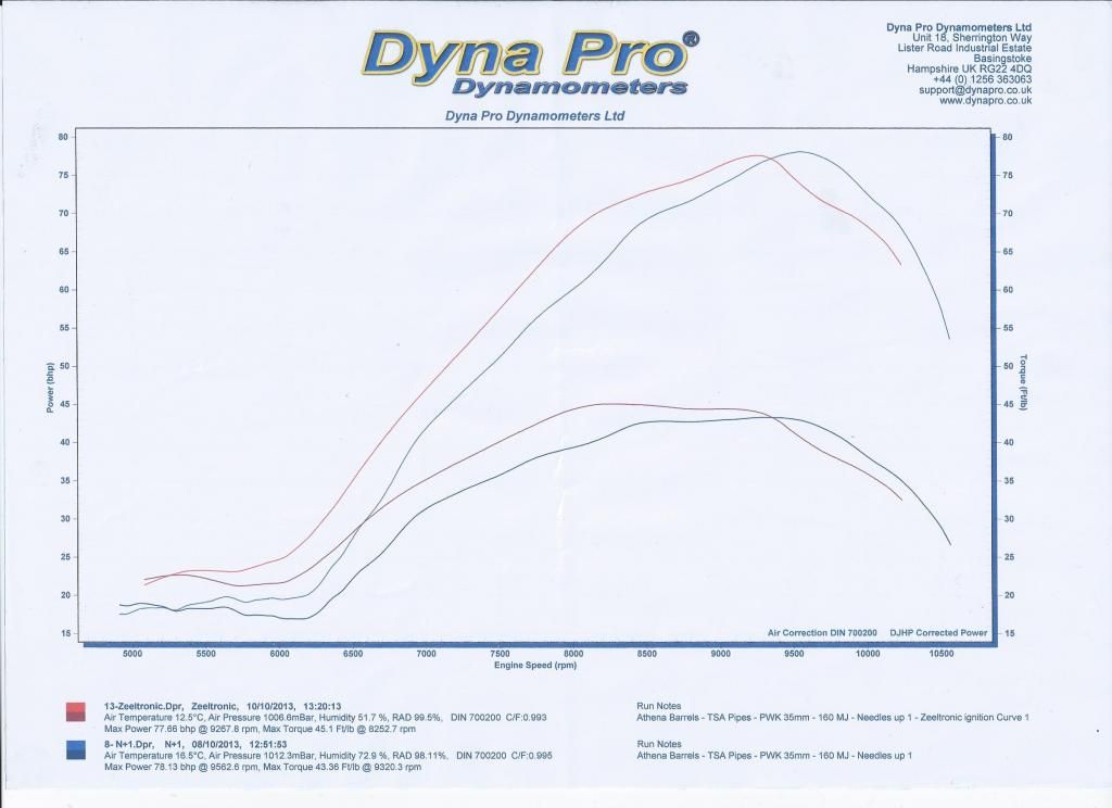

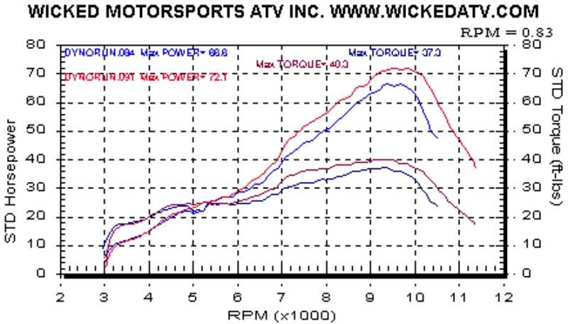

I didn't say anything like that Jon :impatient: The Athena kit promised a lot but didn't really deliver. Shits me that for all the effort they went to to do it but then make some really basic blunders. EVERY dyno graph from Athena kit bikes jump 30hp over a 1000 rpm as soon as they come on pipe. Fine if you want to go in straight lines.
Takes a fair bit of work to get the mid range back just to have roll on power.

These are 2 i just found, one is WinnerEvo's dyno, im seeing about 22bhp over 6-7k, and in Wicked's about 15. ie when the bike reaches its powerband, and pretty much 'as expected' I reckon. Looks more like a good way to woofle about in the lower revs in traffic and then when you get some open road to pin it and hold on. Maybe its more the way i ride LOL Ive never suggested that these bikes are for city traffic use, In fact I have specifically told Pete that if he wanted that he should buy a Scooter, and... he already has one, a Gilera 180. LOL
Im wondering if the percentage power gain between 6-7k revs is the same on a normal tuned (pipes etc) standard 350LC (ie the sans PV motor). I cant find any good dynos tho of sensible bikes, most have 20+ bhp there like the Athena does if they are MickAbbey tuned etc.
