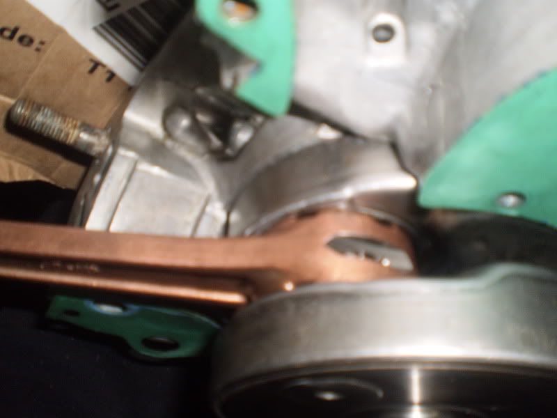

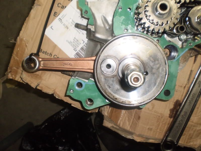

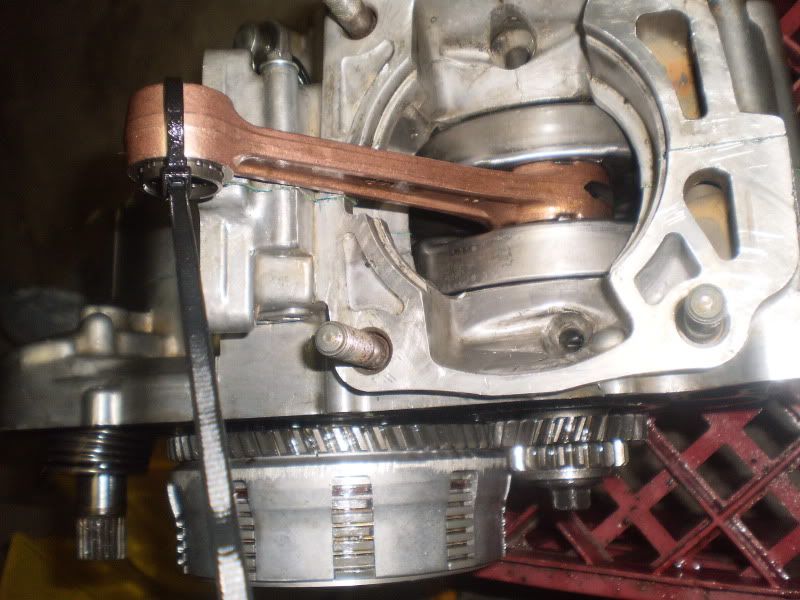

Finally some real developments
crank if back from the engineers and rebuilt with the machined crank webs, yz490 rods and silver plated bearings all within perfect tollerances !!!!
thanks GRAHAM!!! highly recomended!

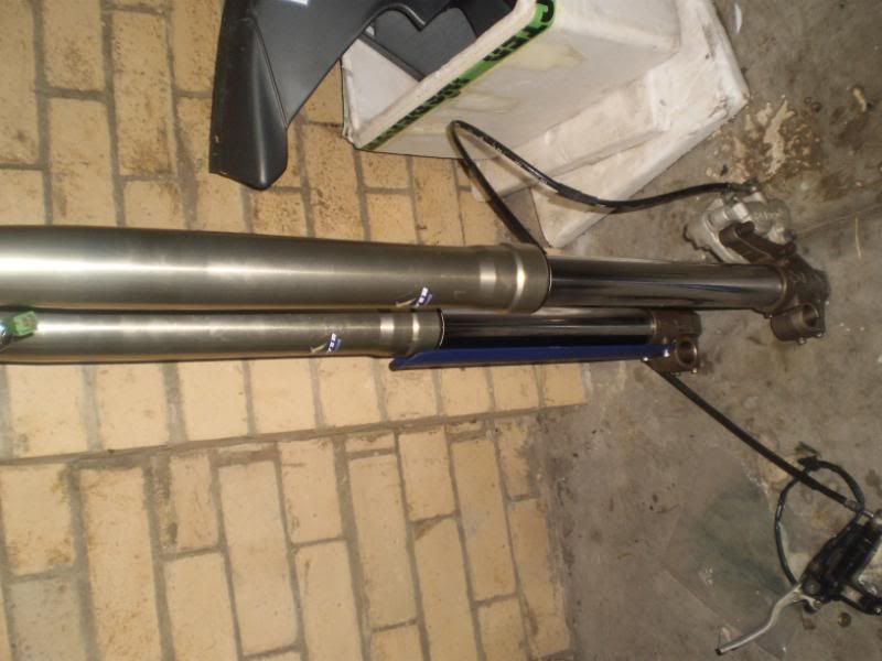

just bartered my way into selling my CRM forks and buying some Husky SMR marzochi forks with brembo caliper and m/c....
should work a treat with the marzochi wheels...
should be interesting to say the least...

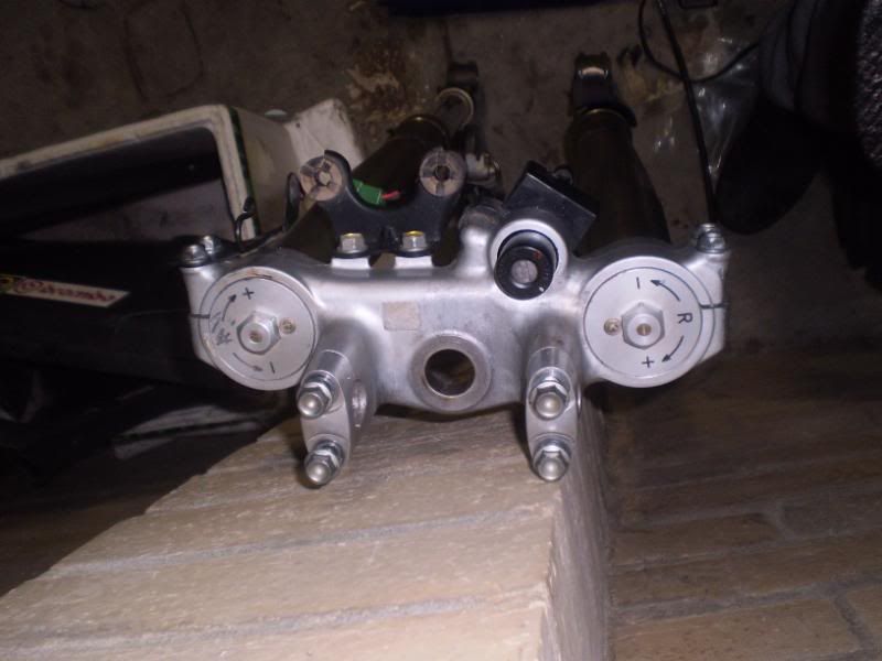

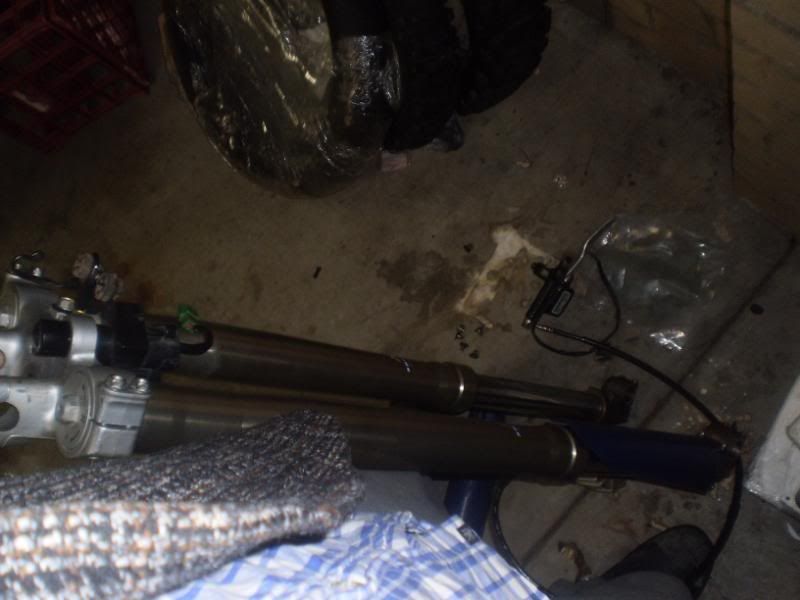

Its official,
I have found the new optimum fork swap for the crm250
cheers NGK and bruce.
fits straight in top triple clamp, and just need to bore bottom triple out by 1mm

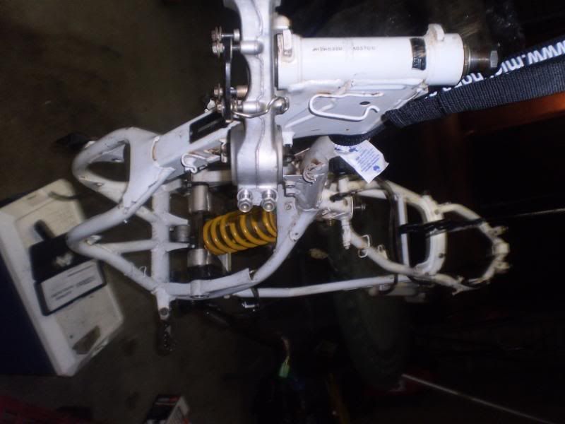

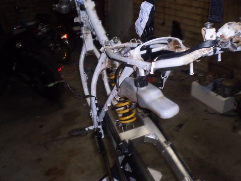

frame is completely stripped down for cleaning

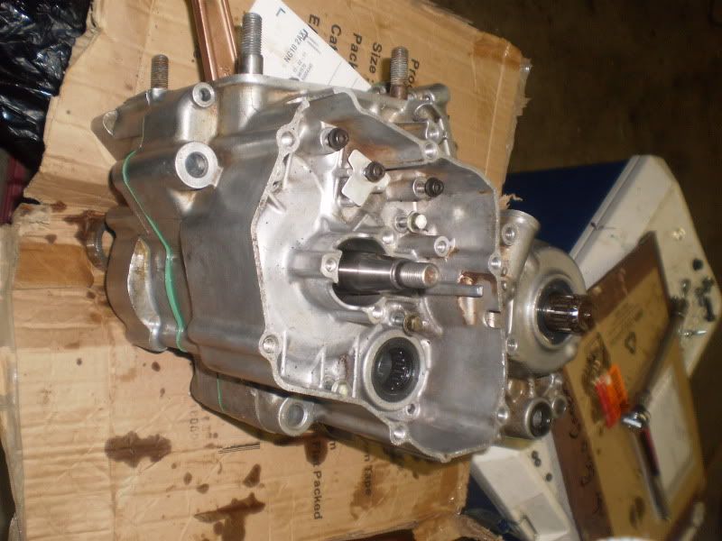

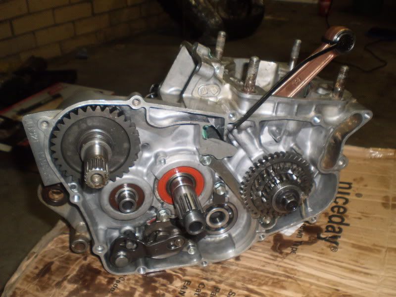

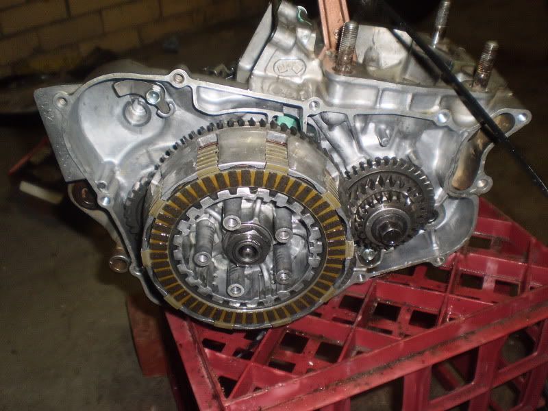

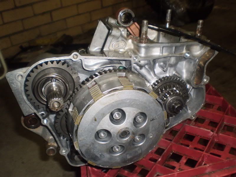

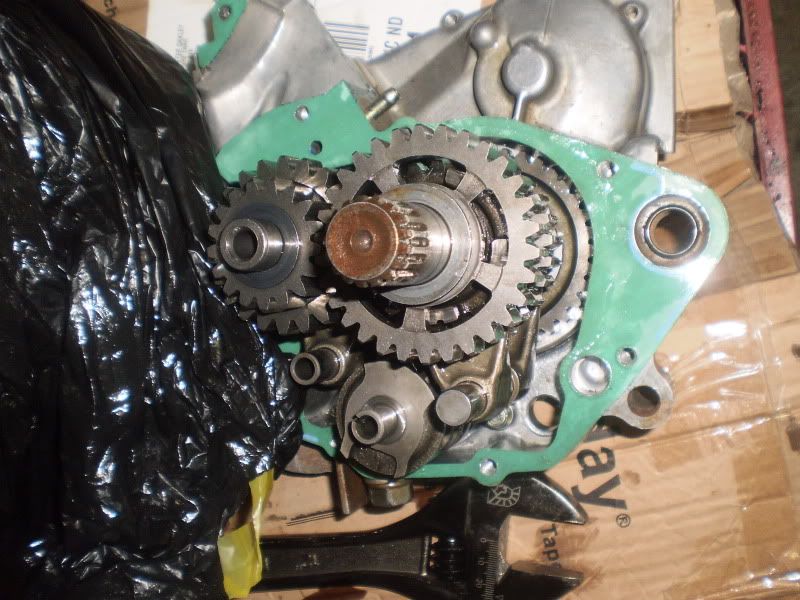

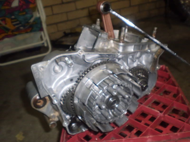

Got most of the bottom end done tonite, basicly just need to get myself a larger socket to torque the clutch basket, and a rattle gun/loctite for the alternator and primary gears

Iv just gota borrow a clutch tool and a larger socket set and some loctite so that I can finished off the bottom end.
Im forcing myself to take my time with this rebuild, and make sure I follow the manual after I made two blunders and had to spend time backtracking to fix them
