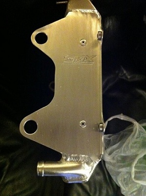

OK so this is a basic drawing, but I had an idea that might make this rad a little more useable for all. What if we put screw holes in the side and then can bolt up almost any ally panel for fitment you want, eg LC or RZ.
Needs a little more work, but let me know what you think.
Possibly could then incorporate a bracket to run around back to hold an R6 fan ?
Or put screw mounts in the bottom so could mount RZ plates and also send mounts for fan from bottom.
Any further ideas before i get something done in CAD ?
Also anyone want to double check my measurements ? I have now made the bottom and top chambers extend full length across and angled them at the front aka Smads design in UK I got from JonW, and increased width by 20mm each side and put in the extra 9mm outlet in top chamber.
If this design is OK ill get Mr CAD to draw it up better and include the side bracket drawings too.

- This is like the side plate, see how its riveted then welded, we could make this screws on with stainless screws so we could use diff plates
- smads side 2.jpg (42.09 KiB) Viewed 4332 times
