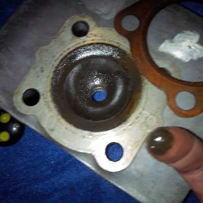

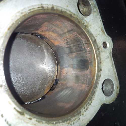

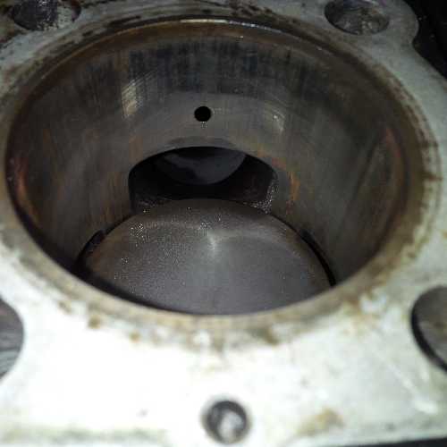

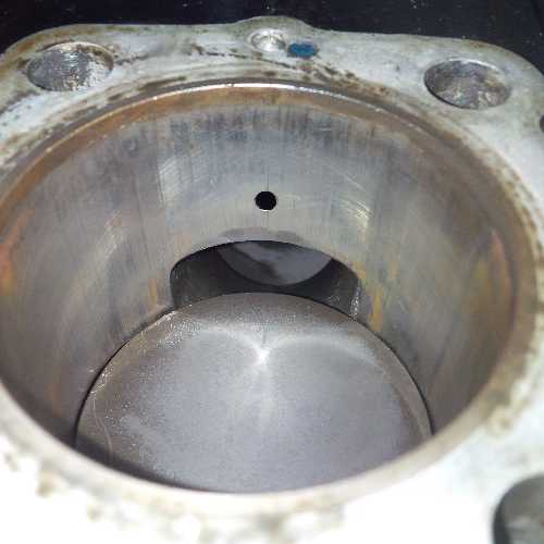

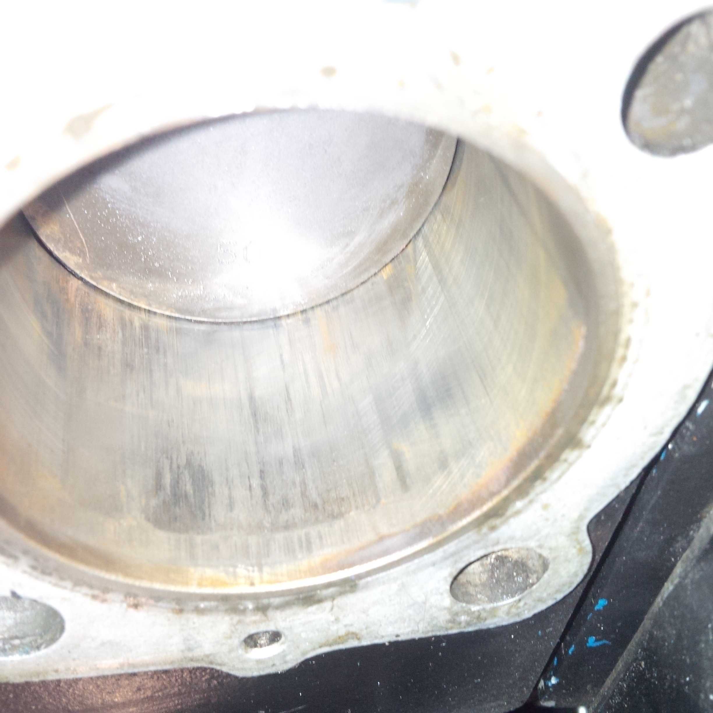

Pulled the head off the noisy cylinder today. Images attached. The marks on the intake side can be felt with my fingers. Link below to Youtube video showing me moving the piston back and forth with my fingers.
While I was tinkering I pulled the oil lines off at the carbs and alas, no oil came out nor could I see any in the lines.
Haven't tested the pump yet so not sure if it's buggered, needs adjusting or has blocked lines. Lines look new.
http://www.youtube.com/watch?v=uSaTiGrGyw4&sns=em
Any comments and/or advice?
Thanks
Blue

The piston looks oily.. I don't think it's lack of oil.
But just by sight... that looks like a lot of piston clearance in those bores.
You can put a bit of premix in the tank, start the bike, remove the oil lines (block the hole in the manifold) and pull the pump to full. You should see oil start dripping out.

They look like Mitaka pistons to me and they are for the LC. Not a big deal but you will get a rattle even with a new bore but everyone runs them without incident and that looks like new pistons in an old bore. Do what Hybrid said to check the pump but I suggest a complete engine strip because looking at that you cant thrust that engine and the AC motor is cheap to rebuild.
