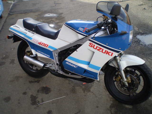

I am now on the road after buying that one then trading it back two weeks later against a better one.

hey
what year is this one
also is the front m/c factory as it has the remote res
beautifull looking bike

Sorry Mike just say your post. That is a radial master cylinder that came with the bike and its an 86. How is my old one coming along
