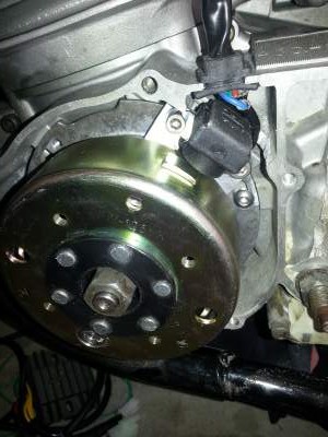

Im in the process of building a 1974 DT 250A from a total basket case, well milk crate case, 3 of them.
I hope to finish up with a street tracker look with under slung pipe.

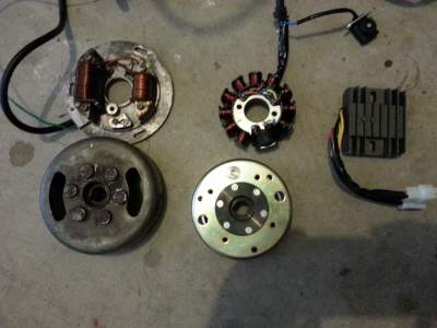

I didn't want to spend $700 on a power dynamo, so i did some research and came to the conclusion of using a 11 pole stator and mag for a GY6 Chinese scooter, the parts are cheap and plenty full. Into the bargain you get electronic ignition and 12 volts.
I also found a racing CDI unit for a Yamaha jog as it's a 2 stroke.

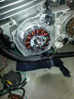

The mag fits with the woodruff key being stepped, easy. I cut the original coil mountings off the stator plate and drilled 2 holes to mount the new 11 pole stator, made a plate to mount the ignition pick up.
I had to cut away some of the engine casing and the cover to clear the ignition pick up.
Plugged it all together, span it with my drill and we have a spark. Next i will have to get a strobe timing light and move the pick up actuator in the correct place. the mag is about half the weight of the original. I have a reg rec to suit.
Stator $26, mag $26, reg rec $22 and the racing CDI $24, all parts found on ebay and Australian stock.

I wonder what the output would be? The new stator looks to have more wire in it that the original winding, so its probably more!
The weight saving in itself is reason enough to adapt this, plus losing the points and condensers, all for 100 bux! Bargain.
