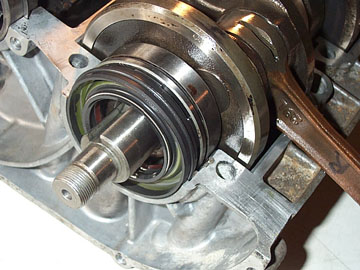

hello all ive just rebuilt a 1983 rz350 ypvs
and it seems I have a leaking right hand crank seal, very frustrating , so my question ?
Is the right hand castellation crank seal suppose to go with castellations facing inwards, towards bearing or outwards
thank you for your help
RH crank seal
RH crank seal
- rh crank seal.jpg (65.36 KiB) Viewed 3284 times
Re: RH crank seal
From answers I obtained here in the forum, you should have the metal spring facing out, which from looking at the picture, you do.

That's wacky, it doesn't look right, not that I would know at all, but on wheels and other bearings seals are generally around the other way, with the hollow side facing in.
Re: RH crank seal
Have a look at my '86 ypvs restore thread. I asked the exact same question. I got a link off Jon that had some pics http://www.scooterhelp.com/RZ_help/rest ... crank.html. Hope it was right.

Thanks for replying people, after some research on here, I'm assuming I have the seals in the right way, but they are "YAMBITS" seals, yes, anybody used crank seals from yambits , is this the reason gear oil is getting into crank , why they no good ?,

Gday Neil. Correct orientation for right hand crank seal is castellations to bearing (facing inward) you have it correct in the photo.
From what i have read on many forums the yambits seal are not of great quality. I allways use genuine yamaha crank seals, they cost more but give piece of mind and save you dollars in the long run. The same can be said for head gaskets, allways use genuine yamaha. I once used a non genuine head gasket on rz350 and on the first ride after installation i got a hundred k's from home when it started leaking. One more thing yamabond 4 gasket cement is best for engine cases and i spray holomar gasket jointing compound on head gaskets prior to installation. It's a bugger when you have to learn this after you have spent the money on a product that you would expect would do the job. I have bought many other parts from yambits for various vintage yamaha's and mostly i would rate there products. You would think there seals would be ok but i have read to many negitive reviews on them.

Neil... STOP! The best advice anyone will ever give you on our bikes is - "Throw those yambits seals as far away from you as you can, then buy and fit the genuine seals."
