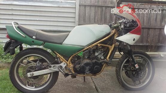

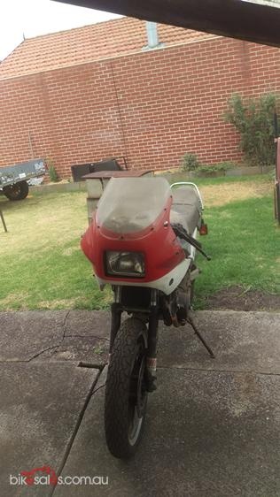

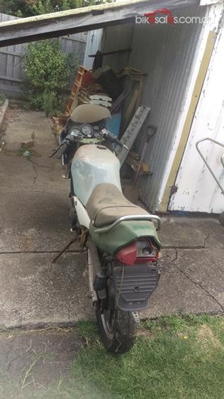

The bike is a original 85 Rz350 with matching frame and engine nos. Photo is how I purchased it.
Will update when I get time to organise and sort photos. I am by no means an expert in rebuilding bikes, but hopefully have a few tricks and ideas that will benefit and inspire one or two people.
The Starting Point.....
Anyway, another forum member has asked me if I would post a rebuild post so here goes.

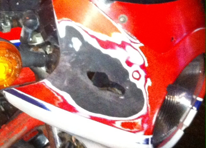

If anyone is trying to repair their plastics, look up these guys...http://www.trimfixsupplies.com
He sells a great little kit for about $60-80.
It is designed for ABS repairs and includes a bottle of ABS liquid, ABS powder, Monomer, re-enforcing tape etc....
I have used this product with amazing results.
Rebuilt a 83 bikini fairing that I thought was beyond saving, but now as good (actually stronger) than new.

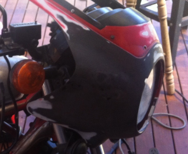

Before and after photos using repair kit

I repaired the hole by placing re-enforcing tape on inside and glued in place with the liquid abs. Once set, masking tape on the inside to shape of fairing. Get a small glass bottle (something like food colouring bottle) and put in powder. Add liquid monomer and shake. Add liquid until you get a nice consistency then pour into hole.
Depending on thickness, do not disturb for at least 8 hours. It may take 24hrs or more to set properly. Be patient. Build up and create shape with liquid abs.
For smaller indentations, sprinkle on powder and add monomer with supplied eye droppers.
For cracks, " V " out one side and stop the crack by drilling a small hole at the end of the crack.
Apply powder along length of crack and add monomer. Let it set and then repeat on other side.
Several applications will need to be done. Overdo it like body filler and sand/file back.
Body filler will not adhere to ABS. This stuff does
