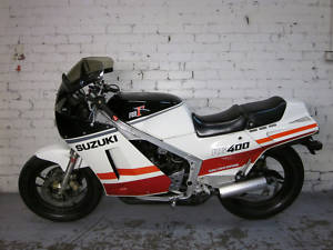

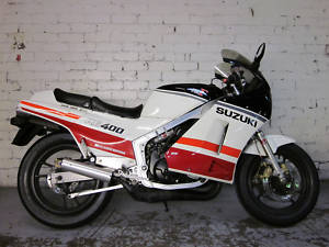

I'd be very interested to hear, as I've just bought an RG400 to go with my other 2smokers. The first thing I'll do is try 125 jets to see how much this leans it up and probably drop the needles by 1 notch too to see if going leaner gains power.

My newly bought RG400 - ring-a-ding!
