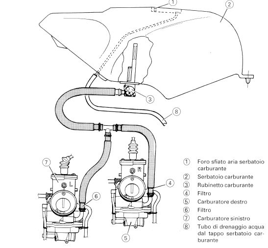

The fuel line runs from the petcock on the tank to the carburetors, which part was damaged?

I'm guessing you are talking about the carburator(s)?
See see the diagram attached.
