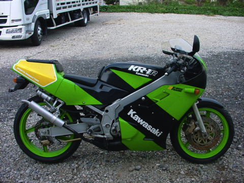

I have a KR1-R . 150 made and most destroyed by Kamikazi pilots in Japan prody racing . Few outside of Japan . R's had 35mm Kehins , close ratio gearbox . upgraded clutch springs , programable igniter box.
KR-1 WORLD REGISTRY - Models, Frame Numbers and Engines MODEL IDENTIFICATION

- kr1r.jpg (251.43 KiB) Viewed 19557 times
Re: KR-1 /KR-1S
nice post...
I didnt even know there was a KR-1R, nice.
The KR1R is only trumped by the X-09!
