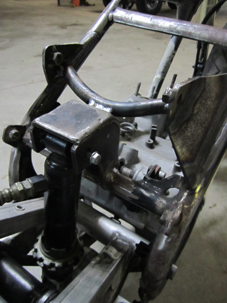

Application is for the RZ frame that has been modded as per Eddahenrys post rz/rgv/r6 hybrid and a bit of extra subsequent bracing by Laurie Alderton at Smithfield who didnt seem to worried about it and said the welds and frame all looked pretty solid.
I read on another forum that eddahenry was going to temper the frame and get an engineering report for it, but I was wondering if I really needed to ?

So this is the main area I was concerned about - the shock mount eddahenry put in for the rgv shock and the extra bracing I put in to make sure the shock mount wouldnt push it forward.
Whaddayathink ??
Whaddayathink ??

Hmmm, Jeram thats pretty cool, but a bit over my ability and current tooling... Think ill have to go with sticking it in an oven. think ive got a mate at Uni of Wollongong who have a pretty good engineering dept- he he

The only concern would be that it was not done on a jig of some sort, but of Laurie said it was OK I'd be happy with that. BTW if you want wheels straightened (spoked/cast) Laurie and his son are the go. They Did Jerams RS wheel for $120 or so including shipping. Might be worth starting alist of suppliers Jeff????

Well Laurie certainly wasnt too concerned about it and it certainly looked like he was doing similar work for a hell of a lot of people / racers.

Looking again I would be inclined to add a few curved gussets to that boxy top mount(ride height adjuster would be ideal to) both at the base and top in the verticle plane to the horizontal cross members and one to the curved cross member in the horizontal plane. To quote Masao Furusawa frames should 'bend like a tree in the wind'.
Curved gussets transfer the forces in a gradual manner.
