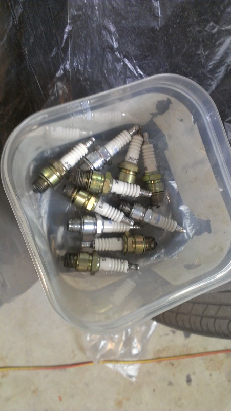

While faffing about getting my 500 to run properly, I went through a few plugs. A threw a fair few out, but recently started chucking them in a box.

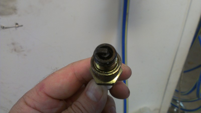

Heres one of the offending plugs:
First I sloshed it in some wax and grease remover (prepsol) to try and get rid of some of the fuel/oil buildup so that the grit would not stick to it.

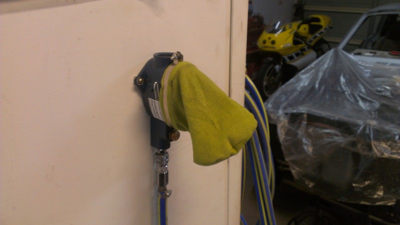

This is the cleaner I bought.

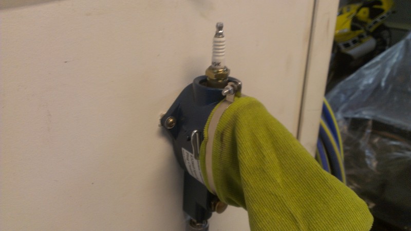

Whack the plug in the top.
The cleaner has a lever where you can open or close the grit, so I started with the grit off just to dry the wax and grease remover. Then I would open the grit lever and blast away for around 10 secs. Then turn off the grit again and blast to clean the grit away.

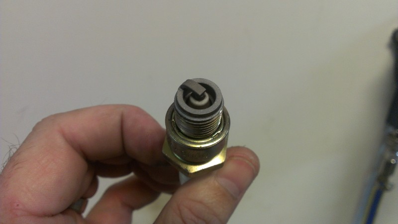

The result:
So maybe I'll have some plugs to try next time I foul one.

Looks good. It use to be standard practice to use a grit cleaner to clean plugs, every shop had one and part of a service was to blast the plugs. Champion plugs use to have a specialized cabinet which included a test unit (to check the strength of the spark). I'm not certain why they fell into disuse.
If you save ten plugs you save $120 8) . The maths should work :) .
