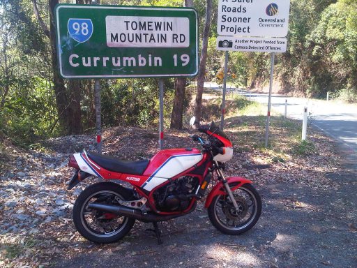

That's pretty much what my bike looks like, but missing the top fairing instead of the bellypan. Your cigar pipes look in nice condition.
