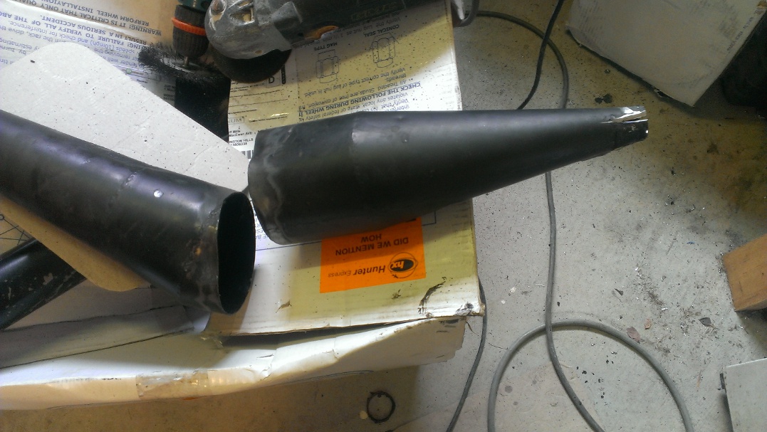

Anyhoo... I got buried in the job and forgot to take progress pics except for this one:
I cut the pipes open because I expanded the end of the stinger inside, so had to slide it through from inside out. This is obviously not a problem if you're building the pipe from scratch.
I used 1inch exhaust pipe, which gave me around a 22.2mm internal diameter (1.6mm wall)

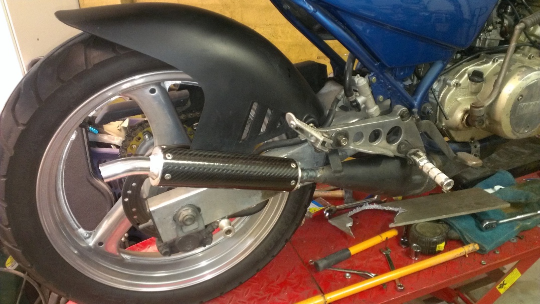

I still need to remove the pipes again to clean them up for paint. Just put them on to hear it.
I used TYGA flanges with the holes drilled slightly bigger to fit the TZMike cans.
The verdict? It's definitely quieter. Not sure if it's because of the TZMike cans, but I doubt it. The 500 is bloody loud with 4 of them on it.
The internal stinger seems to take some of the edge off for sure, and I'll be asking Lozza to do it on the 500 whenever that happens :lol:

The main difference is the sound as you take the bleed off from the highest pressure point at the end of the rear cone. In the belly pressure is much less. I usualy make a small cone to replicate the last 50mm of the baffle scone on internal stingers. You could just as easy have short stingers as length is not important.
Re: Internal stingers
You make that cone on the end of the stinger inside?
I just expanded the end to make it slightly bigger.

So I took it for a ride this afternoon to pick up some high temp paint.
It is WAY quieter than it was before. I'd recommend this to anyone wanting a quieter set of pipes without a doubt. Performance has definitely not changed. If anything, it felt a bit nippier, but thats more likely to be due to a slight change in stinger size rather than the fact it's down in the belly now. Considering it's such a hot day... it will probably be even better in colder weather.

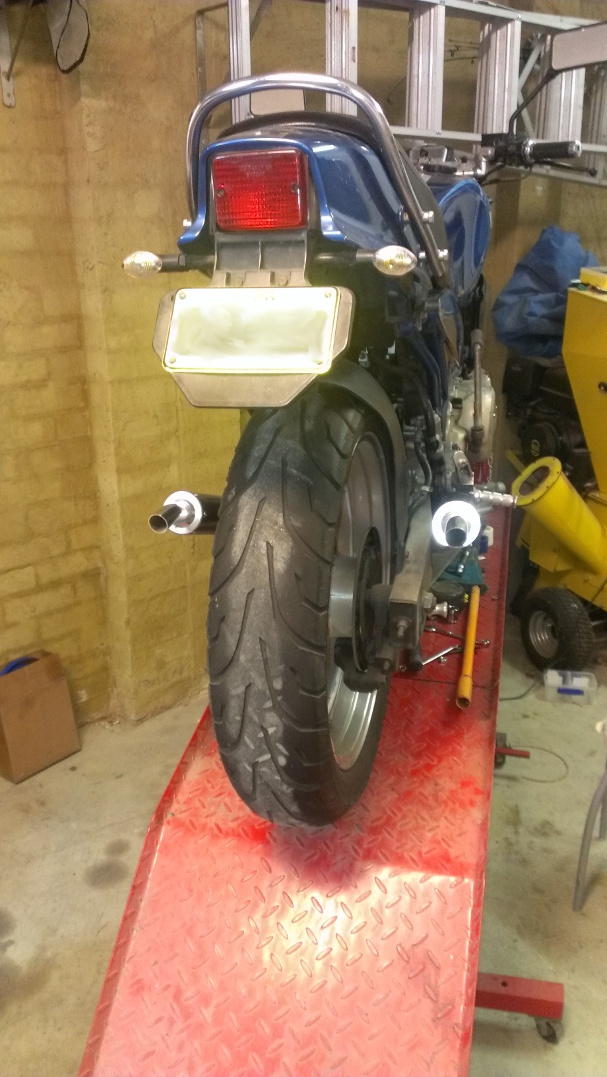

Jeff is it just me or are those stingers at a uneven height? :)
Just you or camera angle! We measured and tacked in place, then checked again
