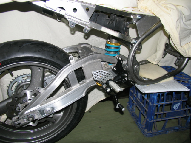

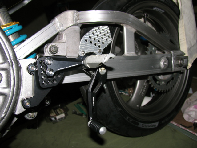

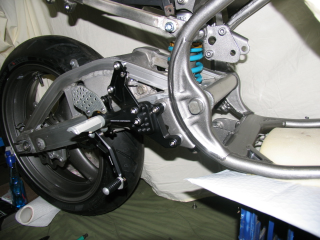

SO I got a little bit of time to see how the rearsets would look on...
